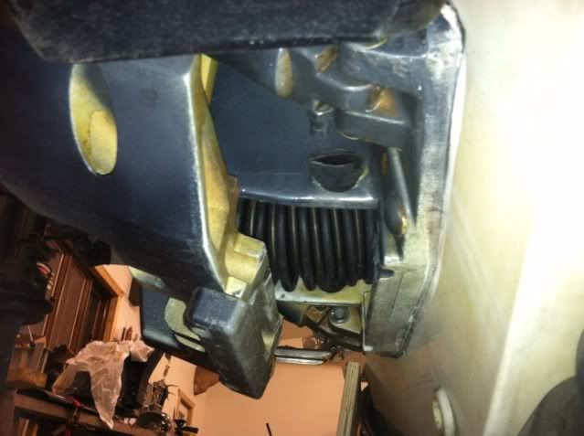

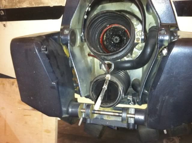

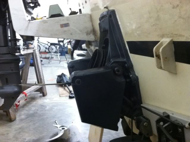

I do not see a trim pin anywhere on it. Looks like the tilt mech stops right on the transom plate.
Here is what I'm looking at now.
The only pin that I see is the one in the pic and it doesn't appear to be adjustable in any way.

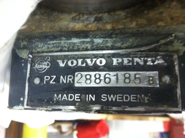

Here is the tag off the upper gear case.

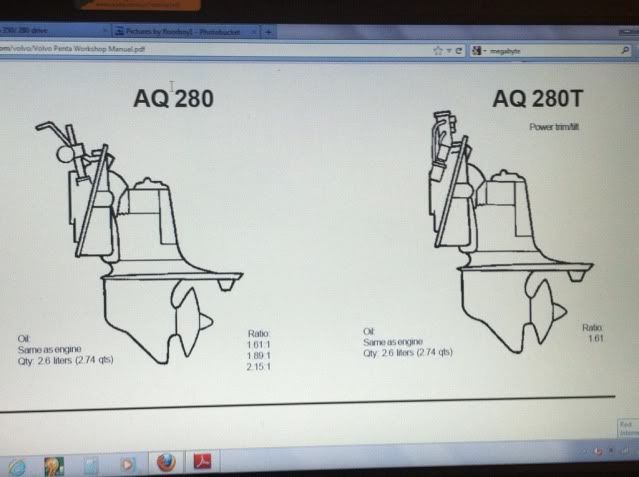

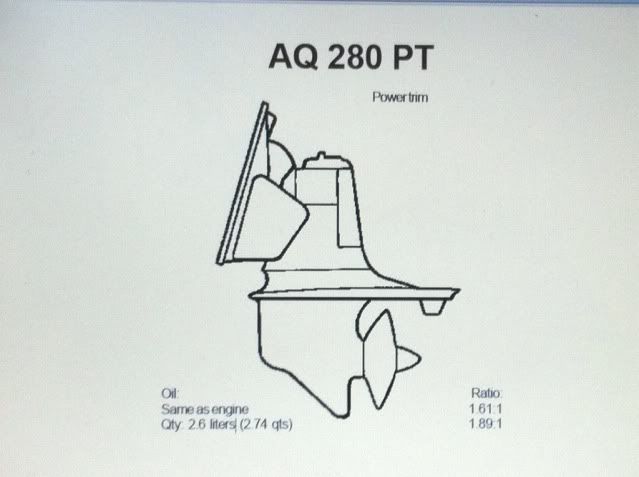

Ok just looked at the workshop manual again....... Is this a 280 pt?????
Sure looks like it from the drawing.
Doesn't look like a regular 280 or 280t?
If that is the case should I keep it or change it??

I made a mistake above and should have said 280 PT. There were some problems with the 280 T. I have not worked on any but have read up on some issues.
Yes, you have the PT which has power trim. Personally have only seen 3 of them live, and only have worked on one, lol. :p
