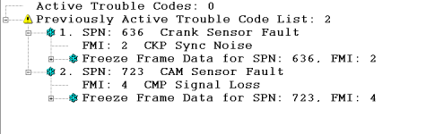

Attached are the 2 codes that were flagged. I have not tried clearing them yet since I can't get the engine to start a second time I didn't want to take a chance of taking it out for a trial until I can get clean consistent starts. I wasn't sure these were preventing the engine from starting because it does start once, but then each subsequent time after that it won't (until I check again the next day)

You should be able to connect to the engine and reset codes with just the ignition on and not running.

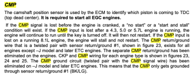

I was just looking through the diagnostics manuals from Diacom, and found the below section which aligns with what I am experiencing - How do I know whether the issue sits with the Crankshaft Sensor or Cam Sensor, when both were flagged in the codes?

The way I read it, the motor will start and it's not stalling so the CMP is not lost.
The motor does run but doesn't run very well and with both CMP and CKP codes, I would lean toward the CKP.
