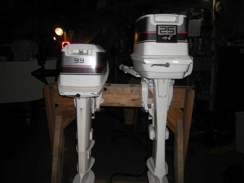

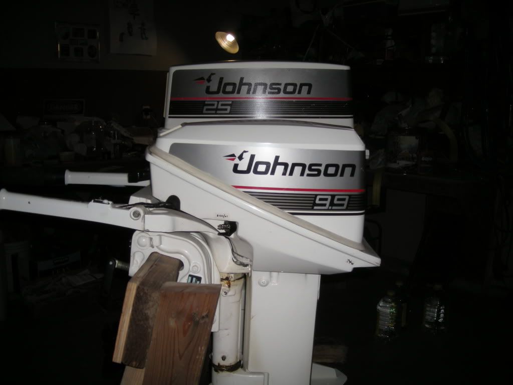

Oh and the wife was not happy that I bought the 25hp johnson, she was insistent that my 9.9 was plenty big enough accomplish what I was doing. But when she saw the size of the 25 next to the 9.9 she was impressed about the size difference. So it does matter how big your johnson is lol

Yeah she has been in the family since birth :) My father bought it brand new in 87' and she still looks showroom new under the cover. Been very well taken care of and would never again find one in the condition she is in. It is actually a 15hp, I did the mod upgrade on it last year with the 15hp carb and exhaust tube. I may put it back to the 9.9 though now that I have the bigger Johnson. I am going to sell my 2001 6hp 4stroke Tohatsu this year though which is also in mint condition. It came with my boat and has about 10hrs on it is all.
