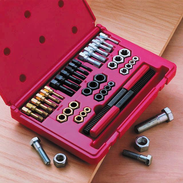

The craftsman thread chaser set # 52105 looks like this ...
spin_prod_206508001
Its either going to be the 5/16 x 24 bolt ( more likely ) or the 5/16 X 28 bolt ( never seen one ). The sears kit has the 5/16 X 24 chaser.

Just take a old rod bolt and cut slots longways on threads, this makes a great chaser and NO LOCTITE!!!
