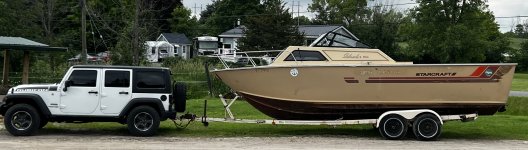

I am rebuilding an 84 Starcraft Islander.
Engine 3.7Mercruiser
Adding holley sniper

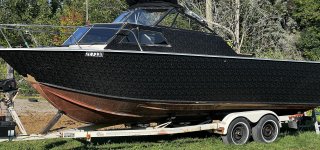

Heres the latest.
Ive completed the wrap. Ive also been running the boat for a couple weeks now and its running pretty good.
