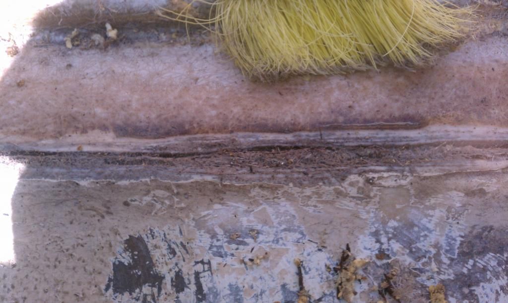

Thanks for the photobucket trick. Here is the white glass im talking about.

Also as i am grinding down what is left of the glass for my stingers that is what im finding. is that grinded enough and will i need to use glass to reseal there?

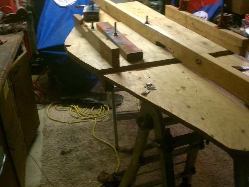

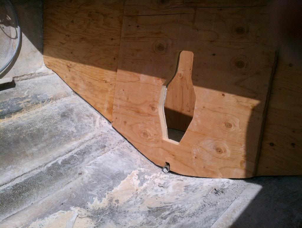

Its been a while however i am still working... slowly... the inside is grinded down and the transom is being constructed. Her are some photos.

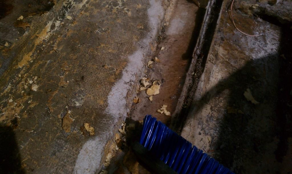

There is so much pb used in the construction of this boat look where the old base mount was and look at that lip... that lip is all pb

get rid of that brass plug in the bottom fill the area with PB and re-drill the hole also pack all the voids (gaps) around the bottom and sides with the PB

Thanks for the info on the brass fitting. That is a dry fit of the transom... I will indeed fill all the voids with pb. So my question now is if you look at where the engine would sit you see a bunch of old pb bondo and what ever else they used... Do i need to grind that all the way down to the hull? Will glass stick to that... i dont mind grinding it i just cause it shows me exactly where my motor mounts go. Any info you guys got would be great...
There is a bunch of this all the way to to bow... Looking at other build it looks like everything should be grinded down to the hull... let me know :)

yes you want to put fiberglass on glass NOT glass on paint, wood chips, gel coat, dust, spilled resin or any thing else. wipe the area down with acetone before applying fiberglass to remove oils.
