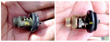

Fresh or salt water usage, how old is the motor ? Which was the thermo condition when removed ?

Salt water for the last 10+ years. 1989. Old thermo looked clean when removed.
Assume it's not the original thermo the motor came with as to look clean specially if running on salt water for the last 10 + years or has been cleaned ?

Yes, I have changes the thermostat and impeller a couple of times in the past.
