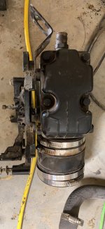

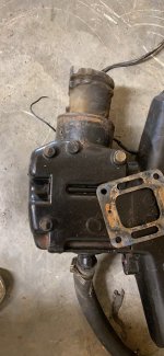

•I am interested in some new risers because mine are a little rough(pic attached) and also i have heard a lot on how much the risers can help with performance..? I can see that on the pricing as well... lol but risers are on the parts for sale list, along w many others: which is where a lot of my handwritten questions marks came from.. I will also attach my Engine Specs as well.
•The parts for sale list also has a a single holler double pump 750 CF carb better than my original carb(pictured in attachments) if I rebuilt it?

Don't need a 750 CFM carb for a SBC, its more carb then the motor can use. Only need 600 CFM like a Edelbrock 1409
Don't need a cooling crossover pipe, just a circulation pump
The distributor listed is for a TB 4 or 5, don't need a ECM need a TB module, or change to Delco EST
If your old exhaust is fresh water, more then likely their fine. Headers will do you no good because you do not have enough power to make them a benifit. Now if you went to aluminum manifolds and stainless risers, then there is a weight reduction which would help
I don't like one wire ALT's but they do work

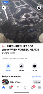

Started with a “floor patch”.. then found a jb welded block.. pulled engine and bought a new one. Engine builder I got it from said the cam would be fine for a boat
