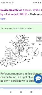

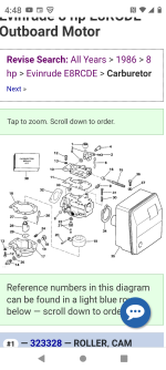

I think your going to find a lot of differences between the 86 carb and yours.
I think the year the seller listed must be wrong. The main reason I bought it was after seeing the part # on the plastic top plate is identical to the one on my carb, and everything else looks identical, minus the choke thru-pin.
Here are some pictures for comparison:
My carb:
Carb I bought off eBay:
My carb:
Maybe, it has the rich/lean screw on the right side like your old one. 86 was in the front.

1. Idle mixture adjustment is out 6 turns because the engine needs more fuel than usual to run, meaning air is entering the carb or crankcase somewhere else (possibly lower seal?) and it needs more fuel to balance it out and stay running. Engine runs rough because the final fuel mixture that reaches the combustion chamber is way off for the spark timing the engine is at.
2. Idle mixture adjustment is out 6 turns because that's just where the needle wants to normally be on this carb, nevermind the usual 3 turns out. Excess fuel is entering from somewhere in the carb, or possibly from a leaking fuel pump diaphragm.
To me, the engine is running rich - plugs are dark, can't idle down to 700RPM happily, 4-strokes at mid range RPM because it can't burn all the fuel.
