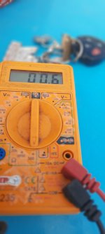

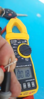

Actually your right. One mmeter says
0.6 and other one says 1.7

billdy
Jun 13, 2021
8
so if it reads1.0 when touched together ,how can you measure .26 or .9 ohms
On checking again it's 0.6 on one and 1.8 on other.

yep when trying to measure small resistances always measure lead resistance and subtract it from the actual reading.
they use small flexible wire in the leads of different lengths, so no way they will be 0
