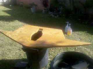

i finally have some picture updates. here is my son helping cut the transom
here it is ready for sealing

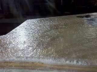

and here it is fiberglassed, you can see where im having trouble keeping the edge down.

When I have a pain in the butt corner With wood under it I staple it. Cloth can not try to flex up. I assume you are cutting the corners to allow them to lay flat also. This trick makes life so much easier.
twkjr 1250
Mar 6, 2009
177
Re: '90 19' open bow galaxie restore progress
cut corners like proshadetree said and where ever else it wants to bunch up, also check your fillets i used a 1 ""pvc pipe to ensure a nice radious some people use a tablespoon. if you just grinded the edges you may get away with just a over size tab in . watch how thick your transom is getting tou want to keep it close to original.
