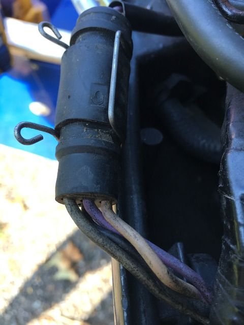

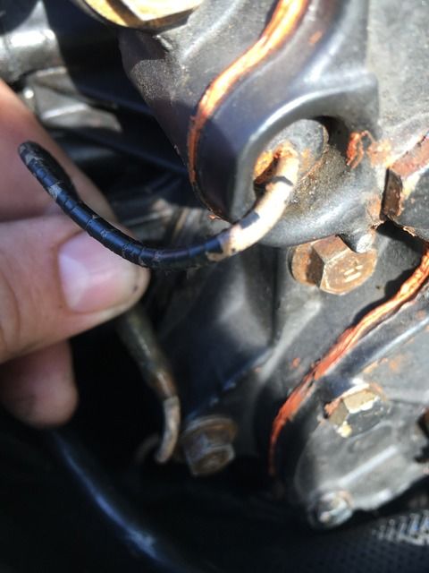

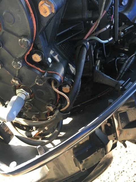

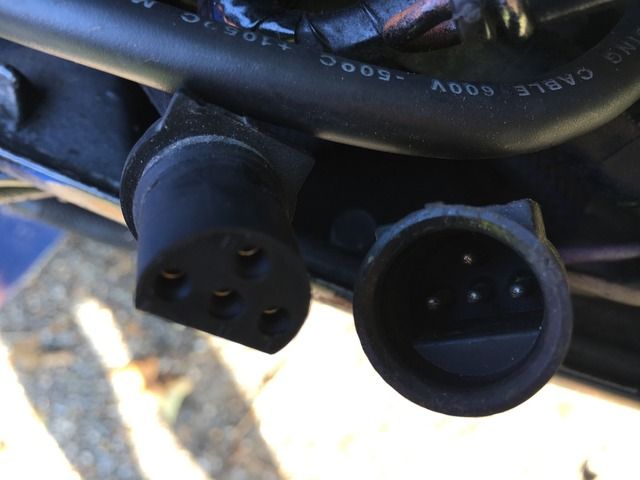

flyingscott ..... i found the plug you were talking about ... i UNplugged it ( pic1 and pic 2 ) i have 2 overheat sensors ? looking at the motor from the back ...theres a sensor with a brown wire ( pic 3) on the upper left cylinder .. cyl #1 ?? and another with the same wire on the lower right cyl .. Cyl #4?? ( pic 4 ) should just unplugging the 4 wire plug from the VRO get rid of the alarm ? like i said the motor ran cool. thanks again

The first 2 are for the vro pump. 3 and 4 are temp. There is no need to mix your gas if your vro is working. I unhooked my vro and just mixed my gas on my old boat. So if your ok with mixing your gas just leave the vro unhooked and blocked off.

Just leave the vro wiring unhooked that should stop the alarm going off. As for those other pics. Feel free to rush anytime lol
