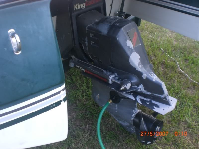

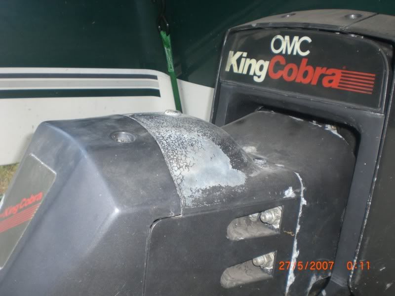

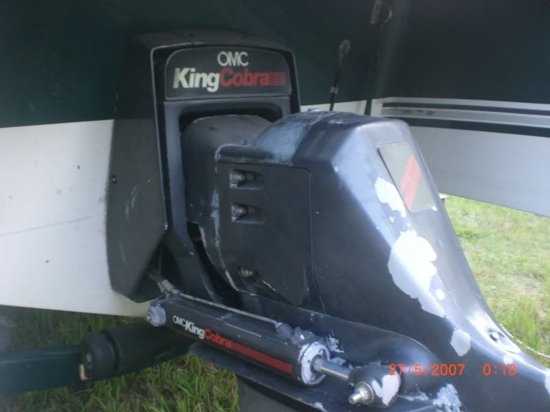

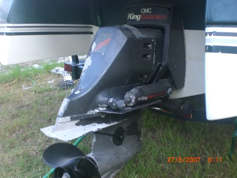

Take the cover off the back of the drive and snap a picture. That will tell all.

Back cover. On the drive.
It sure doesn't look eaxctly like an SX to me. Cover looks different.
HT32BSX115
Dec 8, 2005
10,083
Re: 95' 7.4 GL Cobra with King Cobra sterndrive.
That does not look like an SX.
If you remove that cover on the back of the drive, you'll find a raw water pump underneith. You SHOULD do it too and inspect/replace the impeller..... unless the previous owner can prove it was replaced recently.
Don S
Aug 31, 2004
62,321
That is NOT an SX. It is the old style King Cobra cone clutch. :eek: :eek:

i thought it was a cone king. On another forum they said the hump on the top denotes the cone king....
O well, Not worried now. But for later what will i need to do to swap out to a duo or bravo 3?
