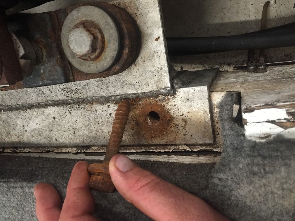

5. Now the big one. Looks like the floor, possibly stringers need some service. Floor does some moving while going across the lake and there is some softness in the passenger side. Looks like the floor support is separating from the stringer. And also looks like the stringer is not sealed up very well. Stringers seems solid. But I assume something here needs attention.
Driver side stringer.
Passenger side
Man those are bad pics. But the aluminum is a cradle the engine bolts to that bolts to the stringers. Looks like the floor support on both sides is pulling away from stringers. I'll try and get a better pic but it's kinda hard.

Well I pulled the access panels up and did some investigating. Looks like the stringers are trash. There is a bulkhead right in front of the ski pole. The stringers are good once you get right past the transmission. I pulled a bolt and holy smokes there is nothing inside. They spent some time very wet.
So I assume I need to cut the floor up and try to see where the damage ends. Do I cut the floor all the way at the edge or what? It appears that there is no fiberglass just epoxy paint that's all cracked up.
Do I buy treated plywood for the stringers or special marine wood of some sort? I see online guys use all sorts of stuff. I'm pretty good with fiberglass so that's not really an issue. I have some resin and a roll of glass. Also some q cells and stuff.
So I'm thinking pull up 1ft of floor outside of the stringers and see what I have to start with. Oh yea I guess I have to pull the motor very first. I'm not real fond of that since all the electrical connections are sealed up really nice unlike the floor :(
I drilled into this stringer and it seems fine, any tips on making sure?

Pulled the motor out this evening. I was impressed all the wiring was in 1 big plug besides the ground and hot wire to starter. I'm gonna do some cutting tomorrow and see what's up.
It really looks like there is no glass on the stringers just epoxy "holding them down". I don't see how that's a good idea. It's so easy to lay even just 1 layer of glass.
I'm curious if I can simply sand and lay some glass to hold the stringers where they are still good. I assume I can bond to the epoxy with regular resin If I sand it a little.
