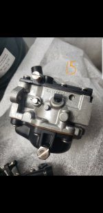

Hello all, I recently bought a 15 hp carburetor off ebay, in great shape, but did not see where it said the carb had an electric choke before. My 9.9 choke was manual..my question is, how/can you convert from manual to electric. What all parts do I need. Any info would be greatly appreciated, and if you can link a video it would be a huge help..thank you

What's the part numbers for the 2 you've found? I cant find the carb using the number stamped on it

Prepare to get in the weeds. That would usually be a part number for the carb part it's stamped on. The carb number is typically a tin tag held on by one of the bowl mounting screws. You can verify that you have a 15 by looking at the throat size (See Leroy's Ramblings re. 9/15 hp J&E.)
Good luck with the project. Maybe the Ebay seller will exchange for a 15hp choked carb to put on your 9.9.

How about-----436778 , 437979 , 438026 , 436779 , 439129 , 439128----listed for J15REDS

If on Ebay, you would need to get the seller to show (in the above example) that the carb came from a J15REDS -- would want to see one of those numbers for the carb he's selling. (And something more than a number he derived from the motor model number.)
