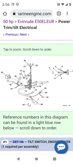

Couldn't find your exact model but number thirty two on the picture is it. Follow the blue and green wires to it location.
Good luck.

Ya I’ve seen that and didn’t help me any. Searching the model number it always directs me to a different number like that number doesn’t exist. I’m stumped
