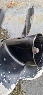

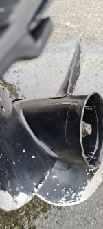

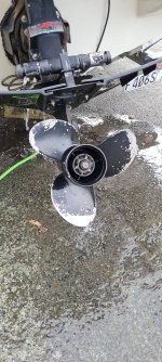

Question 1 is around the propeller, it looks like it's had a hard life but whether it's condition affects how it runs is part of my question. As we use the boat for towing a biscuit/tube, skiing and wakeboarding, is this the correct propeller to use? The writing on it is Solas E3x14.8x7R. I have seen 4 blade and 5 blade propellers before, which is best?

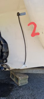

Question 2 I have labeled the picture with a number 2 - what is this device/contraption?

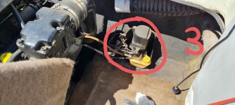

Question 3 is aligned to picture 3, which oil pump is this?

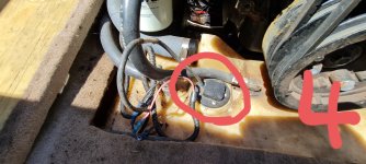

Question 4 is regarding my fuel gauge which is not working well at all, it jumps from full to 1/4 to 3/4 to full to empty 100 times a minute. I was told to check the contacts in the fuel tank, is the part I've circled in picture 4 the correct place I should unscrew and inspect?

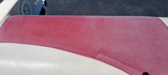

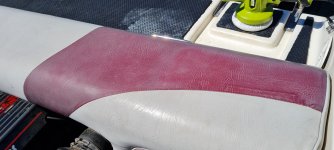

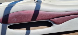

My last question is regarding the vinyl seats. They are badly faded and a shade of brown from dust and dirt and heaven only knows what else. I've tried soap and water with sponges and hard bristled brushes. Has anybody got any advice on what I can try to use to get these back to a semi decent shade of white and red/maroon?

1) If the propeller works well for the water sports and you are hapy with it, then don't fix what ain't broke. If you want to get a bit better take-off for water sports, try a 4 blade with a bit less pitch. You'll have to look up what the pitch is on the current Solas prop.
2) That is your speedometer pick up tube (aka pitot tube) There also may be a small hole on the leading edge of the lower unit of the outdrive that does the same thing. Sometimes when the outdrive 'pitot' gets clogged, folks put on these aftermarket pitot thingys as they are easier to clean out if they get clogged. The speedometer works off of water pressure.
3) Trim pump.
4) That is the fuel sender, so check the wiring that is connected to it. BTW - I have never seen a fuel tank so close to the engine. Not sure if that was original or not. Be careful working around the tank/fuel :oops:
5) Try some vinyl cleaner/restorer on the seats with both a cloth and then a mild scrub brush to see if you can improve the appearance.
Yes, that it it.
Loose or bad wiring would cause the gauge to read empty when faulted.
Jumping between full, 1/4 and 3/4 is normal behavior for a “cork on a stick” type sender.
Change over to a “reed” type sender to resolve the issue

I think you should get a new prop. That one has significant chips, which will cost speed and efficiency.
Make sure the current Tach turns in the middle of the max recommended RPM range before choosing the pitch of the new prop. If so, a 4 blade with 2" less pitch may be better for that relatively heavy boat you have.
The bouncing in the fuel gauge is likely going to destroy the gauge, if you don't fix it. The gauge sender in the fuel tank looks different than the standard one. Check/clean the wiring on the sender and gauge. The fuel sender must be grounded as well.

The speed sensor on item 2 is flipped to the up position. Push it down is it is below the bottom of the boat. It's spring loaded to either the up or down position. In it's current position it won't read dynamic water pressure.

Gee, you can get a brand new Turning Point 4 blade prop housing for MerCruiser for under $100. I use this prop on my heavy 21 footer and it works well.
Cheaper prop housings are also available. Likely a direct replacement for yours is about $75.
A reusable hub for that prop and many others is about $45.
If it were me, I would run the boat up to max RPM with the current prop and then decide what pitch prop I wanted and order new. Keep the old one for a spare.

With regards to the propeller, besides for opening up a can of worms :D due to my lack of knowledge around propellers and how they perform, I am simply wondering if a propeller with more blades would yield any different results in getting a skier or wakeboarder up. The one that is on the boat at the moment works well enough to get my overweight butt up on a wakeboard with 4 on the boat but due to this one looking like it has been used in a rock pool, I'd like to replace it. If the advise I am being given is that this one is fine, I'd prefer to get the same one new as opposed to having it repaired.
I have pushed the speed sensor pickup device to the power position, hoping this works.
I will take the fuel sender wiring off and give it a bit of a clean up and tidy it all up, hope it fixes the situation.
With regards to the vinyl upholstery, a few hours ago somebody asked me why I don't just dye the vinyl - I didn't even know that that was a possibility. Has anybody done this before? I will put a post in the restoration section around this but thought I'd ask anyway. I am considering putting a grey 3M wrap on the hull of the boat so if dyeing the vinyl would work, I'd simply dye the maroon parts grey to match the boat.
