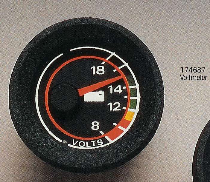

I would say do the simplest thing. But a nice looking OMC volt gauge like http://www.whalercentral.com/forum/attachments/tech-voltmeter.jpg
Then connect a rectifier and and fresh new car battery 60-70Ah, the bigger the better. Then keep an eye on the gauge and if it goes above 15-16 volt disconnect the charging cable or add some extra electric load such as running lights, thus you would create a manual regulator.
