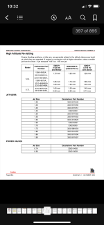

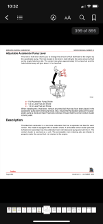

The carb was set up for a 5.0 - the jetting and power valve is the same as in attached file. The venturi is different as it has larger accelerator pump discharge holes on a 5.7. Not to over complicate things but might help to drill out the accelerator pump discharge holes or move the pump arm lever to the closest hole to get a bigger shot (2nd attachment).

The Venturi is larger, as the carb has a higher Air Flow. A 5.7 needs a bigger Carb than a 5 liter. Rejetting is not going to make it a bigger carb
