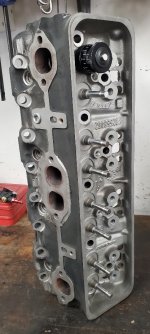

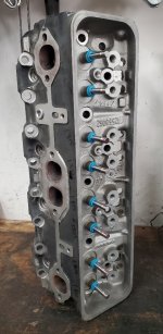

Finally got the cylinder heads back from the machine shop yesterday. They have been there since January.
Now I can start making some progress.

So... I think the 26pitch props will stay on with the new motor. The new motor will run to 5500RPM... so it might be a decent combo.
