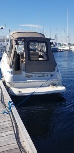

I have a 26 ft regal cabin cruser with a swim deck, I'm looking to I stall a kicker motor, trying to find out what size I can use and what kind of weight the swim deck can hold . Also the best type of bracket for the job. I use my boat in the Atlantic ocean, if that matters lol

Bolt on a fixed Panther 550030 Swim Platform OB bracket and mount a 15 HP on it. That should be adequate for your boat.
Whether the swim platform is capable of that duty, you'll have to contact Regal and ask them.

Thank you for the reply, I will look into picking up the bracket , and I have a older 15 Johnson but in mint condition, maybe I will try that one.

Hi jim, I'm now looking at buying a new 4 stroke kicker motor 15 Hp, what would be best a short or long shaft ?

Bolt on the bracket and measure down to the bottom of the boat. You might need a short or long or extra long. The measurement will tell you.
