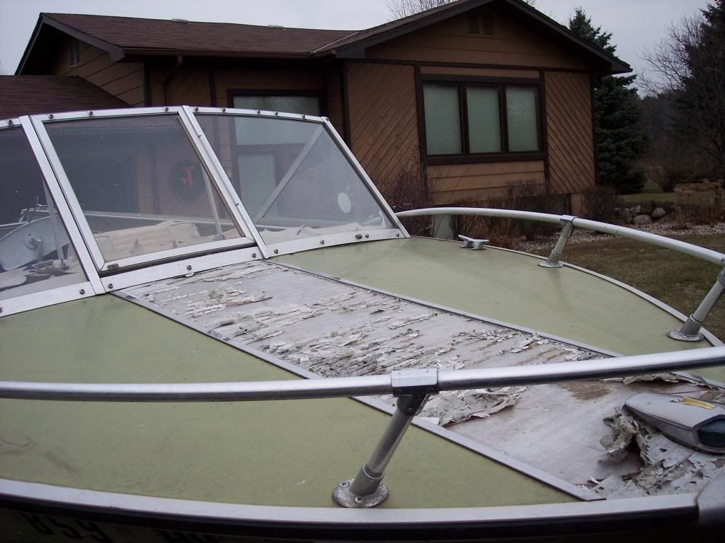

Has anyone added strips of wood to the bow of their boat or if they have the them how are they attached. Can I just screw in to them from the underside of the bow? A group of like 5 strips down the center of the bow. I've seen them on other boats and wonder how they were attached. I look for a photo and attach.

What have (free) is this mahogany type wood from South America I got maybe 50+ pieces of it). The strips are 6 ft long by 3'' wide x 1" thick inch. I cut them down to 2" wide and planed the down to 3/4". Not sure if I'm going to use them yet or not.
The original bow had the white pleated vinyl upholstery material. So I have existing holes, to fill or use. The chome trim strips are in good shape I could just put upholstery material back on it. Or paint, but then I wouldn't be able to walk on it.
I could try to make a pulpit too and put a roller anchor up there. Anyone ever attach an anchor pulpit to there bow?:cool:
