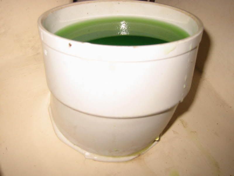

amanphoto
Jun 21, 2008
336
Re: Adhesive Recommendation
Ok, I went with the 5200. We'll see how it holds up. I have to wait a week to do any more work on her and to see how strong the bond is.
Here is a couple of pics of what I ended up doing.
Made the holes 3" not 2.5". The vent hose is 3". The previous vent hose was not even connected to the outside of the boat.
I had to install a PVC elbow because the vent hose could not make that tight corner.

Can/did you get a bead of 5200 between the boat and pvc on the inside?
