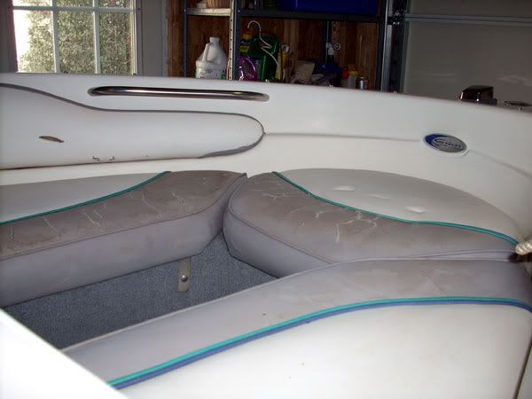

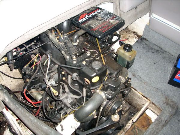

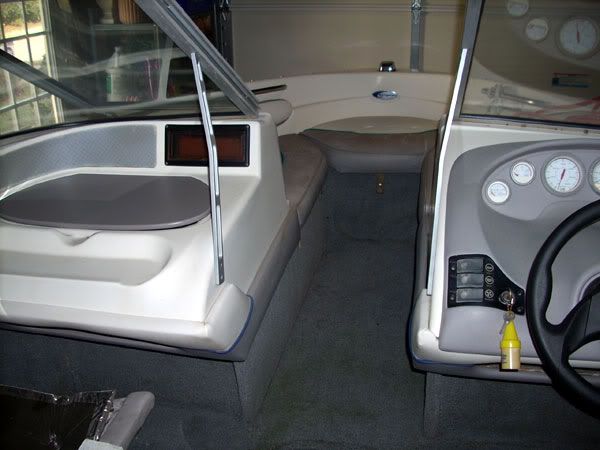

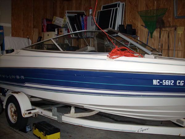

I've included some pics per Bob_VT's suggestion.
Side view
Engine (Mercruiser 3.0L 135HP)
Bow cushions
Bow floor
Front view

If I was you......I would take the boat to a mechanic and have motor thoroughly checked out. If fixable for not too much money, I'd get her fixed. It does not sound like the current rot issues have reached a point where they are safety hazards so I would go ahead and use it for a season. If it works out and you like the boat then maybe tackle a deck repair and reupholstery job next fall/winter. Your 3.0 Mercruiser, if repairable, is a rock solid powerplant and adequate power for that boat. I don't think you necessarily made a poor purchase. Good luck with it.

May 28, 2013
