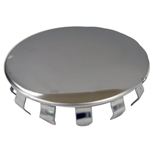

I guess I would chime in on another method for filling in a hole that's as big as a nickle. Peoria you said " have a hole in the deck of my Starcraft aluminum deck" so without a pic of the area I have to guess where the hole is located. I've filled a lot of small holes with JB but the big ones are a bit more difficult.
The Chief was a challenge as I had around 250 holes to deal with, for instance 70+ per gunnel. The cabin had some really big holes drilled for VHF and AM FM antennas. So I chose to use metal hole plugs on them. You can get them in any size needed at the hardware store. I scuffed the surface, SE primed, regular primer and then shot them with matching paint. A small bead of 4200 and pushed them in the hole. When looking at the boat you don't see them, they just blend in perfectly.
