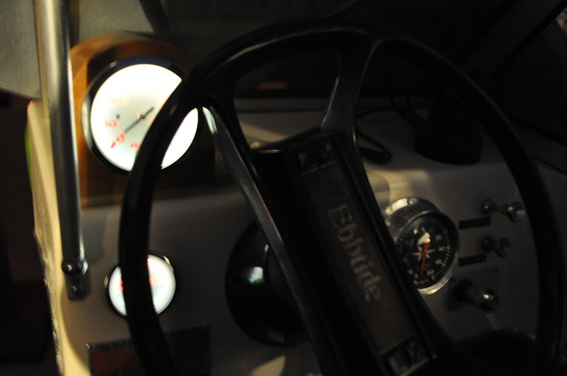

Well I finally got my guages. Yesterday I received my teleflex water temp and RPM guage. I also received the digital laser thermometer I had ordered as well as a small digital RPM guage. I order the digital thermometer so that I could guage my guage so to speak and the tach so I could fine tune the the teleflex tachometer.
Here's some pics on how it went down:
As you can see, I don't have alot of room and I wanted to keep the stock speedo.
I wanted the gauge to go here so I could see it through the steering wheel:
I pulled the steering wheel and cleaned everything up then drilled the hole:
All wiring was crimped, soldered and heat shrink wrapped.

Here's the gauges:
And here they are installed (except for the tach. I'm going to work on a mounting location for it but it's wired up and working.)
Here the sending unit wired up (and my boy being friendly):
My digital thermometer proved that I wasn't running too hot and it matched up fairly close to the gauge:

Ya, I thought about it but on that left side I could have got a 3 1/2" gauge in there but it would have been very tight. I don't really need the tach as a permanent fixture, just from time to time so I'm going to try to come up with something slick. I'll post it on here when I get it figured out.

I was thinking of a swing out pod from the bottom so it could be tucked up away neatly when not in use. Your idea is good though. I need to see how much room i have up top. It aint much.
