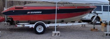

I have been reading that replacing the stringers on a roller trailer is not a good idea. I am at the point of grinding down the old stringer tabbing . I decided to look under at the hull.....needless to say , The rollers are making a small dent in the hull. No cracking in the gel coat.
So , would it be wise to take the boat off the trailer and block my boat at the stern chines and bow center hull? Before installing the new stringers. I have not removed the cap .

If you are noticing any deformity in the hull I would. Possibly you can slide a board between the roller and hull, as long as you are 100% sure the setup will be stable. I did that to mine because my bunks were sagging before I replaced them and it worked well.
