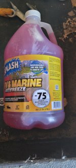

Checked on on my summer place today, and happened to notice out of the corner of my eye that the jugs of -75 RV antifreeze were all sitting on the floor at an angle like there was something under them.
Turns out, RV antifreeze does a pretty good impression of a solid. It definitely expanded enough to bow out the bottom of the plastic jugs. Although there were some areas that looked a little like liquid, it definitely felt very solid.
Weather was about -13F last night, and had warmed up to about +5F.
In any case, if you have a use-case where expansion won't be a problem (sink P trap), not an issue, but if you have an engine filled with it, including relatively small water passages that might have had water mixed, you might have a problem at some point.

Its is rated for burst protection not staying liquid. All of these will gel, then solidify depending on temp, they just don't expand enough to burst pipes At rated temp.

Of course it freezes. -75 isn’t the freeze number, it is the burst point number, says it on the container. It is the temperature where it will expand and burst the media they declare. The manufacturer gets to pick what media they want to declare for the rating as there are no standards that apply. Some use PVC pipe for the rating.

That's the big difference with antifreeze. It's not that it won't freeze. It's just that is doesn't have the kind of expansive power water does when it does freeze.

People see the -50˚F or the -75˚F and think it is the freeze point. It is actually a 'pipe burst' rating and, as has been tested and shown, the AF does start to freeze and expand well above the burst rating.
What I have found is that with plastic components (fittings, valves, strainers, etc.) the -50˚F is not enough protection in many situations/areas, and some components will crack even at around -10˚F. My plastic sea water strainers would crack every year, until I figured it out.
