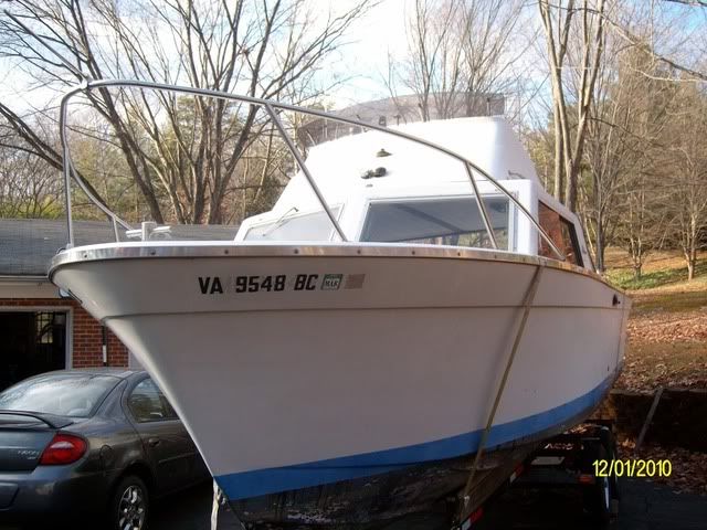

Here is a 1969 with a stainless rub rail. There are no blems in it.
That's really close to what I'm thinking of except I was planning on using aluminum with countersunk screws or rivets instead of stainless and pan head fasteners. That looks pretty good though.
