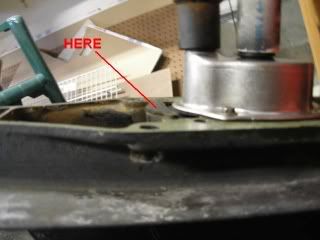

Hi all
Can anyone tell me if this is the correct installation of the rubber water dam (filler plug). It came out the other way (entire dam sitting flush with the mating face of the drive),doesn't seem right to me, it blocks what seems to be a small vens hole in the water pump housing . I am not the original owner so i dont know the removal history. The merc. manual #14 is not clear on this.
1998 Alpha 1 gen 2 s/n 0l123718.attempting to upload a pic. Thanks in advancePicture 251.jpg

If you are referring to the part I have pointed out in the pic, you do have it installed correctly.
