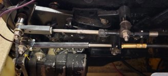

Did some adjusting and the clicking in forward is gone but reverse won’t engage. Doesn’t stall shifting into reverse though. Do I need to adjust again or is it normal to have to move that lower cable stud up to get it to go into reverse with a new cable?
yes the slot on reverse lever is there to fine tune reverse engagement. If someone has the factory manual I believe it is outlined in there.

I’ve watched that one and another one by SEI. I think I followed all their steps/measurements, but still no reverse. The SEI one does talks about moving that stud up in the slot. I just wanted to make sure it’s not odd to have to move it up with a new cable. They make it sound like it’s to adjust as cable get old and stretch.
I'm not sure. Elsewhere in the manual is a procedure to measure the angle it takes to shift the drive. I think this is used to check for wear to shift components inside the drive. Might be worth looking at but would try moving it on the slot to see if you can get it to work.

I got it. I double checked all my adjustments and then moved that stud up a little bit. All is well now. Starts, runs, prop goes in forward, stops in neutral, and goes in reverse. No clicking and no stalling.
