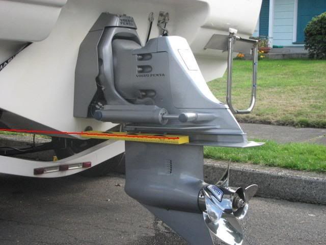

I doubt being too high has any thing to do with it for the simple fact you also have low WOT rpm. Being mounted too high cause the prop to come out of the water which would increase the rpm.
Might recheck your measurement, you can't measure it when all the way down, you have to trim it up so the cavitation plate is parallel with the bottom. Then measure.

Hi. The measurement is With the plate parallel With the bottom. The measurement is 24,6 mm to be exact. The outdrive has 1,62 ratio.

!" doesn't seem excessive.Is the prop in new condition?
You might try an aggressive prop like a Turning Point Hustler.
I assume some of your lack of speed is not being able to trim up far enough.
Is there anything on the transom or the bottom that may be disturbing water near the prop?
Some time ago I read a post here that said smart tabs mounted fairly close to the to the leg
incidentally helped with ventilation problems. 4 blade props are said to resist venting as well.

If your AV plate is about one inch above the bottom, that is fine.
Your problem is that you are using the wrong prop. :grumpy:
Before making my recommendation, I ran your numbers through the Mercury prop selector. With a 4.3L and a calculated weight of 4371 lbs(assumes a dry weight of 3700), it comes up with a 15.5 X 18 pitch Black Diamond, and calculates that it will do 4600 rpm at 41 mph.
This confirms what was going to be my suggestion for a prop. A Solas aluminum 15.5 X 17 will turn 4800 rpm at about the same speed(40 mph). If you wanted to spring for a SS prop, the 15.5 X 17 Solas Rubex would be my choice.
BTW; your WOT rpm range is 4400-4800 rpm.
What you need on a heavy boat ( over 3000 lbs) is a larger diameter prop with less pitch. :)
If I added 200 lbs to the weight, the Mercury prop selector went to a 16" diameter, instead of 15-15.5.
