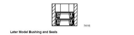

What I am worried about is the direction of the seals. Just for my feeling I would put them in with the U form facing open towards the water side. But in the Mercruiser manual they are both open towards the dry side and this might be the reason why water comes in. Could this be a mistake in the manual or should this seals really be set in both in this direction ?

I agree with your assumption, the lip should be toward the water so it will have a better chance of sealing
Similar issue with seals and the B3 prop shaft. Early (manual 11) has 2 seals and states to place seals in facing each other. First (inner) lip faces out and Second (outer) faces in. Newer (manual 28) changes it to a single seal which has 2 seals in one (opposing each other)
I might tray to do same thing

Thank you for your reply. If the U openings are facing each other then every liqiud going in would be trapped in there ?
I would have done it just the other way round and face the inner one inside and the outer one outside, or face both outside as there should be nothing inside to keep there.
I have maual 14. If anyone has a newer one for Alpha One Gen II then it would be nice to check if this shows the same picture or if this was changed.

Good point the B3 has oil on one side and water on the other.

This is how mine were factory installed and i replaced them in the same manner last year when i did my bellows. Normally i believe the spring goes to the side you want to keep sealed so this is correct

I did check some internet pages and they all say that the spring side is facing the side with the higher pressure or the liquid that you want to keep out. All parts are ordered and will be replaced.
