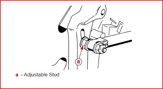

You may need to adjust the post instead of the adjustment screw. I will see if I can find a picture to show what I am talking about....

Not an easy question to answer. Many variables to consider. Use the manual. Adjusting the post ONLY adjusts the amount of throw in reverse. If you are hitting forward too hard post adjustment can cause problems.

Here's the stud I was referring to:
And yes, there is certainly more to it than simply adjusting this stud. BUT adjusting this stud is part of the process that many seem to forget.
