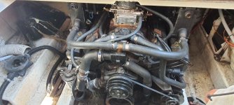

Hi all - my 1st post. Have a 1986 alpha1 5.7L which has recently had a new impeller (mechanic fittted) and a new thermostat (me fitted). During the thermostat fitting I discovered that the upper cooling hoses were wrongly connected so rectified IE t-stat cover outlets to bottom of manifolds, and foward T style outlet hoses to the risers (have had dry joint manifolds fitted x mechanic recently as well). Anyway as I drained a lot of the sitting water out of my system during the hose work I guess the water in the block and manifolds was pretty dry. Anyway upon starting up on the muffs (garden hose full bore has been OK in the past for flow) the engine temp gauge quickly got up to around 200deg F so quickly shut down - then heard a loud rapid ticking sound and boiling sounds, manifolds and risers too hot to rest hand on, but both seemed to be about the same temp. My next idea is to try with the leg in a large drum of water. Could my problem be low flow from muffs not filling out engine internal passages so some sort of air lock? The hoses to the manifolds and risers seem to be hot to touch as well so probably flowing out of t-stat housing. I am also thinking of getting some clear hoses to fit in-line to double check for flow? Possibly also connect hose directly to circulation pump on front of engine and check the flow out of the leg feed hose to see if impeller doing OK. Very low on funds so have to try to self solve to avoid stiff mechanic bills!

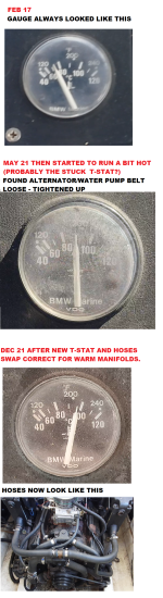

Below is recent history of the engine re running temps all taken after about 20Klm sea run (apart from last pic which is on trailer on muffs after approx 5 mins @ 1500rpm.)

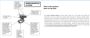

REPORTING BACK.
OK guys great suggestions thanks to all for your thoughts - today I changed the cooling hoses back to the way they were originally AND ENGINE RAN COOLER. Of course the hoses no longer send hot water to the manifold lower inlets, and the cool water is going up to the elbows. So the boat no longer runs a WARM MANIFOLD system so do I new get reduced manifold life via lower temps and condensation? If this is now the "correct" hose connection when using dry joints have Mercury dropped the warm manifold theory? Mechanic mentioned that my older style 6 bib outlet tstat housing water flow may differ from newer models with dry joints standard?
OBSERVATIONS
1. Engine ran at 185deg F on gauge (20deg cooler) jerked around a lot like the tstat was working, but it is rated at 140!
2. Cooling hose tstat housing to lower manifold inlets was quite cool and hose from tstat top outlets was very hot
3. Noticed hot water coming out of transom shield PORT side outlet like a kids water spurting gun but nothing out the STARBRD side (also a bit of a rust flake half blocking the PORT outlet hence the strong squirting about half a metre)
4. Could just lay my hands on the manifolds and elbows for about 1/2 second each
5. Still a minor amount of boiling and ticking noises after shut down
Tomorrow I may pull the main circulation pump though it has shown no signs of leaking or bearing noise. Or is it possible that my tsat housing with the 6 bib outlets is not compat with the dry joint manifolds? They did work OK at first with temp gauge showing 150deg F on long sea runs. Another likely culprit could be rust scaling slowing down the whole cooling flow? Don't really want to pull the manifolds unless all else fails. BTW I do not have any T-Balls on my tstat cover outlets?

were riser gaskets open or closed? Motor's photo indicates that you have a sea water cooled motor and no heat exchanger.

Hi Tank1949 - I have restricted gaskets on my elbows, the restricted hole is just under the cooling water supply hose IE to the front of boat side. Yes I have sea water cooled system and no heat exchanger.
My current theory on the overheating is that it may be rust scaling and restricted flows through the elbows. When I screwed out the inspection plug at top of the PORT elbow it bound up after a couple of turns and then came out quite reluctantly - had rusting and scale deposits on inside surfaces and actually partially stripped out the thread during removal. Thinking back to the start of my overheat problems I found that the PORT elbow was much hotter to touch as well. Anyway there is a bit of a story to my elbows ...
