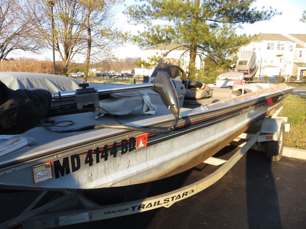

i just got an alum. tracker that has yr's of scum on the bottom :blue:
what will take it off???
do they make a good clearcoat to put back on it???

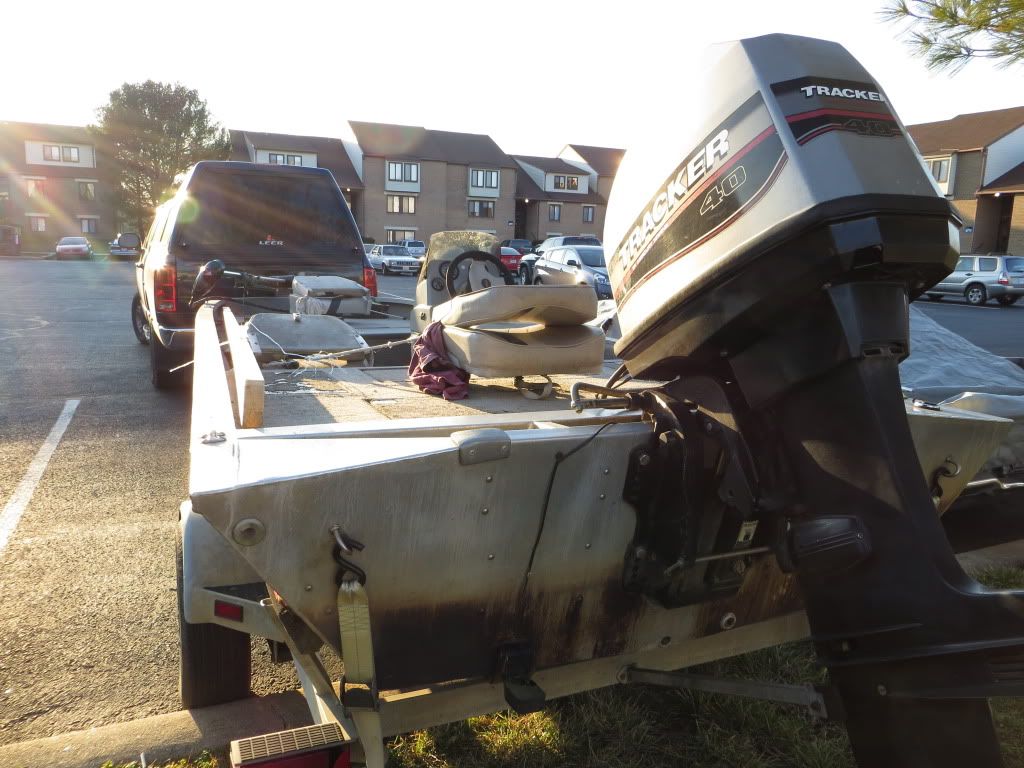

it's the outside
the alum look allmost black will try to post a pic

Outside or inside?
No clearcoat, but there's a product called Sharkhide that cleans, shines, and protects.
Sharkhide
have you tryed this stuff?? looks interesting
so far eazy off oven cleaner HD and a green scrub pad is doing a far job ( lots of elbow grease)
the old owner said he tryed toonbright

jigngrub
Mar 19, 2011
8,155
Re: alum boat help
Yeah, that looks like a tanic acid stain to me. The cheapest and easiest would probably be some simple green and a scotchbrite pad... and lots of elbow grease.

sounds good i think for now i will stay with the oven cleaner and scotchbrite has been the best simple green was like putting water on it LOL

The best place to start is with an acid based pontoon boat cleaner, like ToonBrite--available at any boat dealership. Spray it on, hose it off. You might also have to go the ScotchBrite pad and a strong cleaner to finish the job.
Sharkhide is a thin, clear protectant to maintain a clean, polished finish. They also make an aluminum cleaner, but it's not easily found on retail stores' shelves.
It'll usually get the hull clean but leave a dull finish. If you don't like the finish, any unpainted aluminum boat can be polished for a better shine. I use a 6" wool bonnet on a Porter Cable Dual Action Polisher and White Diamond metal polish (Advance Auto Parts).
My pontoon boat is a near mirror finish.

I tryed toonbrite again this weekend and it just laugh at it :laugh:
maybe oven cleaner lol.try to put it in a natural man made lake for the summer and be ready to clean it little by little.
i did alittle this weekend and yes so far eazyoff and a scrub pad has done the best:joyous:
