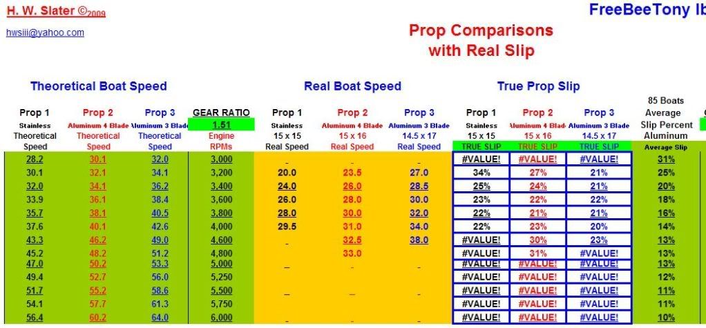

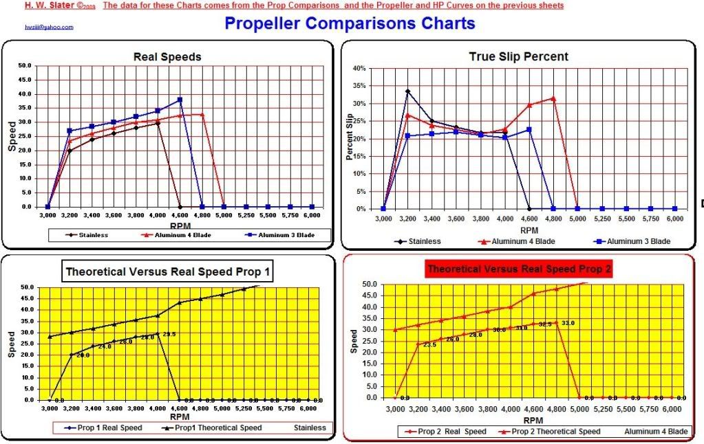

Tony, my program says you should be using a 17" prop for your boat and it should be doing about 42 MPH, and I believe it 100%. BUT, MikDee is 100% RIGHT, you are showing HUB slip starting at 3,800 to 4,000 RPM and it just gets worse as you give it more throttle. That is why I think you quit showing any numbers for the stainless at 4,000 RPM because it was obvious in your mind that you could push it to too high RPMs, and you were disappointed. I don't know which hub you are using, but I know that one of them has changed their guidelines and is now recommending that you torque the hub to over 80 ftlbs, I just can't remember which one.
Your THEORETICAL prop slip for both props that you pushed past 4,000 RPM show a rapid increase in SLIP between about 3,800 to 4,000 RPM, from there it starts increasing. And props just don't work that way on normal boats, as RPM increases the Slip goes down, NOT UP. There is not enough aluminum deformation in a prop below 45 MPH to cause an increase in prop slip from that as there is less than 8 pounds per square inch of pressure applied to the aluminum from the thrust coefficient. The 4 blade shows the most increase in Theoretical slip by an increase of almost 50% slip, as it increases from 21% to 31% in only 1,000 RPM. It is very easy to see on the True Slip Percent chart where your hub starts slipping at about 4,000 RPM.

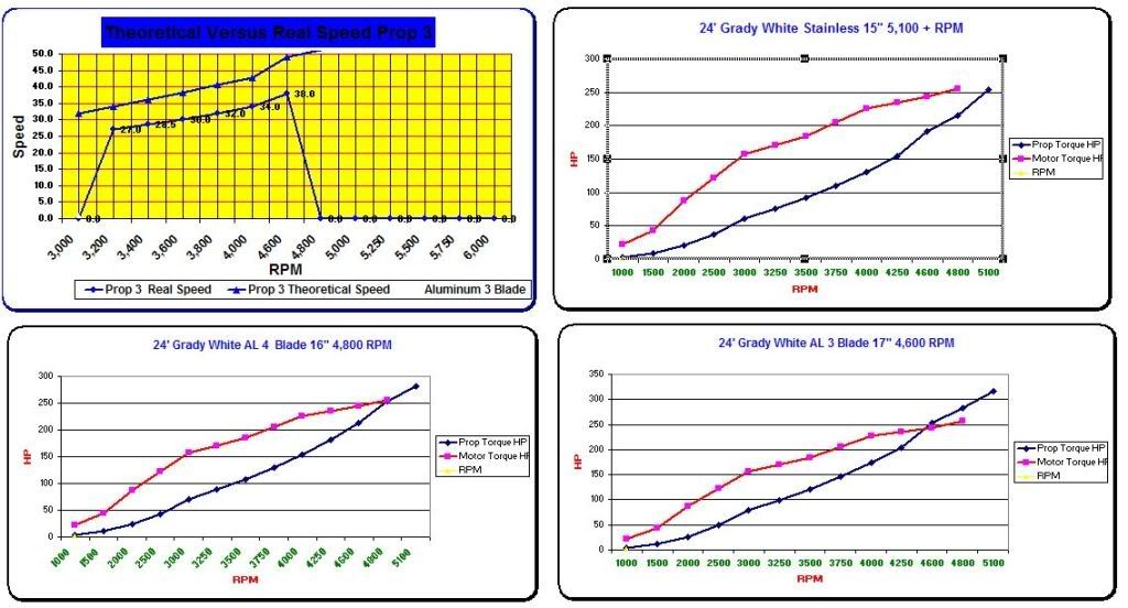

I ran some numbers in my program and then I converted them to charts, so everybody can see what happens as well as I ran some individual charts for each propeller showing Theoretical Speed versus Real Speed. I decided to also chart some Propeller Curve and Motor Curve charts, which I just do for friends, so you could see what is theoretically the difference between your Torque and HP output from your boat and motor combination and the power required for each individual propeller that you are trying, sorry I had to use my outboard power curves for the motor as I can't find my inboards right now. When the two curves meet in the Chart it will show you that motor torque and HP and the individual propeller power requirements have equalized and met each other and it shows the RPM required to do that. The distance between the two curves shows you the reserve power available from your motor to give you an idea of how fast you will be able to increase speed at any RPM setting to a higher RPM, as you look you will see that the stainless prop gives you the best advance speed increase. I also included a Prop Comparisons with Real Slip chart as well.

WOW.....that'a alot of data!!!!
So it does show that the 17" is best suited right now..........and I don't understand prop slip all too well but, I really don't think that the hub is slipping.
Thanks for all the work you put into that, I will look at it in more detail tonight.
