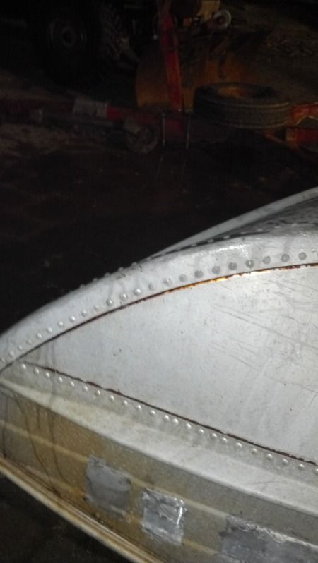

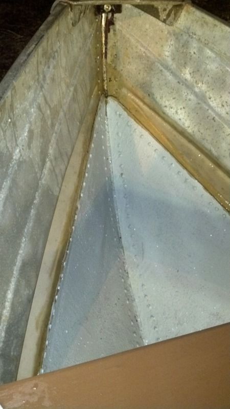

I'm working on an aluminum boat the front of the boat leaks. I had painted all the rivits with gluvit last summer (never used the boat though)
I filled up the inside with water today to check for leaks.
The keel in the front leaks down in the area that's painted gray. No rivits appear to be loose
If you look in the pics, you can see from inside the boat, it's 2 pieces of sheet metal with a keel strip riveted to it. Then in the upside down pic, you can see that red line along the keel, it looks like some kind of caulk, There's some cracks in that and water is dripping out. I don't know if I'm supposed to caulk it from the outside our try and run gluvit or something down between the panels from inside the boat.
Any suggestions.
Thanks,
Nick

Yes you need to dig or heat that sealant out and put in a new bead of marine sealant. Will work like a charm!

Try rebucking your rivets in that area, then I'd wire brush the inside of the hull at the keel, wipe with acetone, and lay down a good heavy bead of 5200.
For me, goo never seems to stop a leak when applied to the exterior of the hull... and it always looks bad.

Actually that red/brown sealant was laid when the two pieces of alum were joined and riveted. So, there is no way in the world you'll be able to dig it all out. On my Jet Star project I removed what was visible just for aesthetics.
Grub has the right idea to try and fix your leak there. Kinda, sorta best to attack the problem from the inside

I agree. I would try to seal it from the inside out, if at all possible. It may just need another/better coat of Gluvi-it applied, but if that doesn't do the trick, a bead of 5200 applied from the inside surely will. I would also suggest leak testing the boat by putting it on the water and loading some weigh into it rather than filling it with water. Keep us posted. Holler if you get stuck.
I just trimmed off what I could and put a nice tight bead in there. Worked fine for me, but I never was leaking a whole ton of water either. I also didn't think it was necessary to pull the floor up on my boat at the time.

The think with more gluvit is I have to figure out how to get it between those panels in the v. I'm thinking a bead of 5200 would me much easier to get in there and cheaper. The smallest size gluvit is a quart and it's $55. A full caulking size tube of 5200 is like $15.

I don't want to be a downer Nick, but anything you do to the outside of the boat as far as trying to stop a leak with goo or welding stick or anything else that isn't aluminum is probably going to look like refried rat crap. If looks aren't that important to you, go for it... but that does look like a fairly decent looking boat like it is right now.
I'm pretty sure your leak is being caused by weak/loose rivets and that's where I would focus my attention, either tighten them up or replace them.

Just an update, I didn't notice any loose rivets, but I hit each one a few times with hammer and dolly anyway, then I layed a bead of 5200 on the inside and the outside. I know the stuff will yellow, but I'm ok with that. The boat is ok, by no means any kind of show winner. First test of filling the boat with water showed no leaks this time. So I'll be testing it in the lake soon.

Once the 5200 is completely cured, I'd give it a week or two, you can sand it and paint it with some aluminum paint and I bet it will be hardly noticeable.
