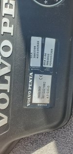

First, my boat: 2008 Regal 1900 w/ Volvo Penta 4.3 Gxi-G fuel injected i/o. i attached a pic of the model / serial # from the top of the engine in case it matters. The boat is on Keuka Lake, in western new york. Our primary residence is in PA, so I don't have the luxury on mesing with it in my spare time on evenings. I'm hoping to have a box of parts for our next trip up and dig into it full effort early Saturday morning.

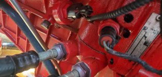

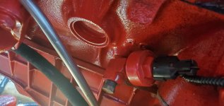

I got towed back to my lift and did some early diagnostics on Sunday before we left to come home. I confirmed all fluids were at appropriate levels, battery was in good shape and no connectors were obviously loose or not attached. Based on the warning tones, my first reaction is the oil pressure sensor is bad. I am having a really hard time finding the right part # for both the one wire low oil level sensor and the 3 wire oil pressure sensor. Can anyone help a) confirm that the two sensors shown in the pictures are in fact the pressure sensor and level sensor and b) help me reference the right part #s I need for replacement?

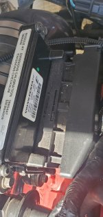

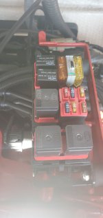

Finally some general questions: I have an OBD2 scanner for my cars. Do the newer marine engines use the same or similar protocol (google says no)? Is it worth getting a code reader for a boat (google says no here too)? I added a pic of the ECM and fuse box incase that was of any use to the thread.

I could really use a little help. I went to the volvopentastore and dug around trying to confirm I got the right sensors to replace the oil pressure sensor and low oil sensor. Unfortunately, the part diagram only calls out "sensors" not what type of sensors they are.
Can anyone in the know point out what sensors do what in the attached pic (or atleast where the oil pressure sensor is)? I think its 19, but want to be sure.

Edit, did some more research:
5 is the MAP sensor
7 is a crankshaft sensor
10 is idle air control
13 is throttle position sensor
16 is coolant temperature switch
19 is the oil pressure sensor
21 is another temp sensor

OBD scanner won't work, need a TechMate Pro or Diacom software from rinda.com
I also pulled the connectors off the low pressure and high pressure fuel pumps and noted that even during cranking there was no voltage to either pump. I assumed this was because the oil pressure sensor was prohibiting them from kicking on
Oil pressure switch has nothing to do with the fuel pumps turning on/off on a MPI motor, only works with carb motors.
Do check the fuses for the main power relay and fuel pump.

Most likely unless its a fuse your going to need to have the motor scanned for codes

for anyone wondering, it turned out to be the fuel pump relay. I replaced the relay and immediately heard the fuel pump prime. Started up and ran fine. Fingers crossed that was all it was.
