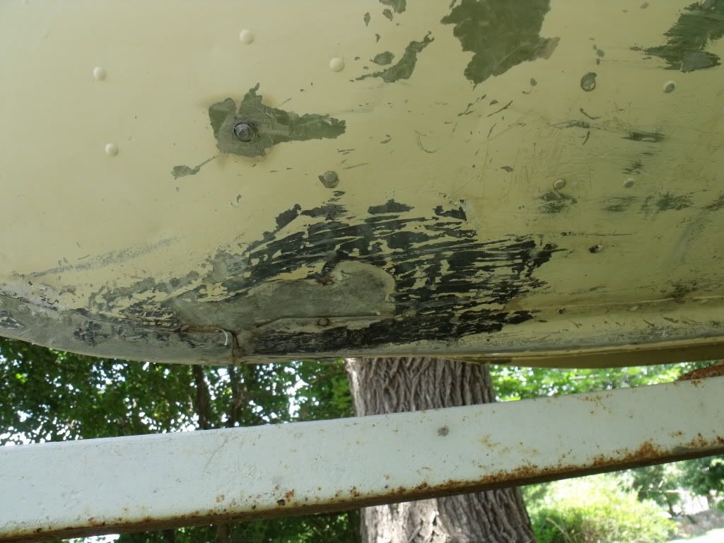

There's a leak. On the outside of the hull, right where the keel begins to sweep upwards, it looks like the boat might have been run into a gravel bar or tree and poorly repaired with bondo or something. The rib inside the hull directly above this point is split dead center, looks like a crack, but I'm not sure. Someone used some sort of compound to try and patch it, but it likely isn't gluvit since it leaks. The water from inside the hull is leaking out underneath the keel channel, and also running about a foot towards the stern and leaking out through a small hole in the channel.
My question is this: Will welding this area up be the best repair, or should we do something else? Also, after the repair, how can we fill the dents?

You asked "There's a leak. On the outside of the hull, right where the keel begins to sweep upwards, it looks like the boat might have been run into a gravel bar or tree and poorly repaired with bondo or something. The rib inside the hull directly above this point is split dead center, looks like a crack, but I'm not sure. Someone used some sort of compound to try and patch it, but it likely isn't gluvit since it leaks. The water from inside the hull is leaking out underneath the keel channel, and also running about a foot towards the stern and leaking out through a small hole in the channel."
Yes that is a common point of leaks and comes from keel damage. ANY cracks that you find would be best welded...... to fill in a major dent or reshape an area I would use PC 11. Once you have the cracks welded, dents filled and all rivets checked (re-buck the loose ones and replace the missing ones) THEN ;) I would give the boat a Gluvit treatment from the inside.

I took a drill-mounted brass wire wheel brush to the area, found a couple of loose rivets and a ton of bondo. I know that smell...it sticks with you. I'm going to try to find the PC11 around locally, I hope. My son just went after a couple of new tires for the trailer so we can tow the boat down to the welding shop. While it's being looked at, I'm going to have the guy give me a price on getting the tongue extended. It seems a couple of feet short to me, and on some of those lake roads, I think we'd have a turning issue. I'm also going to replace the wheel bearings, whether they need it or not. I have a feeling that I'm going to be getting rid of those little 4.80-12 tires and wheels rather quickly. Also need to replace all the rollers and brace the winch up some more.

OK, gonna try to upload a few pics now...one shows the spot of the damage well.

Well, I took the boat down to a welding shop yesterday. Just so happens that the guy is in the process of rebuilding his own aluminum v-hull. He pointed out some rivets I didn't see that were loose, showed me how to reseat them, and even told me where to buy some caulk to reseal the pieces that had come loose. He said as soon as I get the rivets reseated, bring the boat back and he will be more than happy to weld the cracked rib for $15.00. I've used this old hillbilly before, he does beautiful work. In fact, he was making a custom aluminum Hoveround setup for a truck when I drove up. Looked great.
