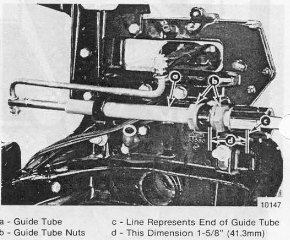

I was afraid to beat on it much, that's why I used the small dead-blow hammer. I had seen that PDF that you linked to, Bt, earlier and I did go through it, even though none of the steering types seem to match mine. I included a pic below, although I'm sure you already know what it looks like. But just to be clear, it appears that the tube is stuck on the far left (in the pic). I'm not sure how to remove the tube with the cable, without taking all of the nuts off that are on the tube. Is that what I need to do, remove the nuts and slide the whole thing out of the transom plate mounts? With the motor back in the boat, I'm not even sure if I can get to those darn nuts. The nuts I'm referring to are part 'b' in the pic. I did put some PB Blaster on it earlier, so maybe that will soak in before my next attempt.

nut"B'" goes all the way to the left as the tube moves to the right untill "B" threads off the tube.

Remove the attaching nut, heat the aluminum tube and pull the steering cable end through the aluminum tube.
Once heated, tapping a wood dowel with a hammer, works great to help push the cable end through the aluminum tube.
Then clean all the corrosion out of the tube and off the cable end, lube it up and it should be good to go.

Ok, sounds pretty straight forward. Thanks for the clarification on the nuts... that's how I figured it came off but wasn't sure.
