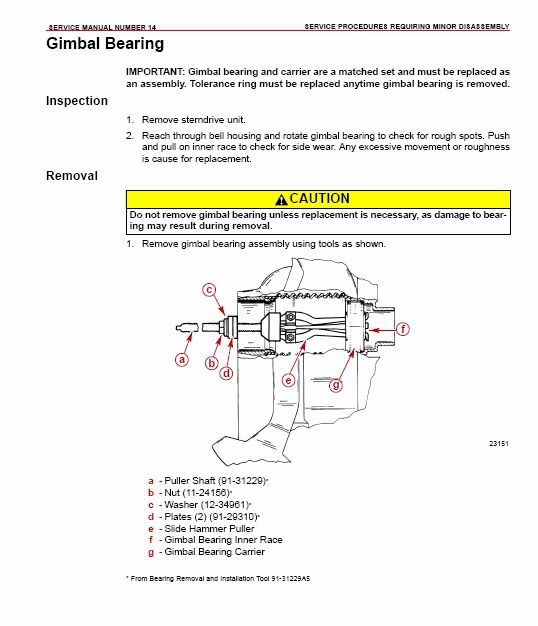

WAIT! STOP!!
Before you do what "G" suggests you might want to look at the factory service manuals and procedures. Been a LONG time since Mercruiser recommended just changing the bearing and not the carrier. The bearings and carriers are a matched set and should be changed together. Here's the bulletin from the #1 drive (70's and 80's?? As I said, before my time).
http://www-alt.mercurymarine.com/mne...t/85/85_26.pdf
And here's the page from the Alpha Gen II manual (#14 I think). Note the first sentence on the page, right after the word IMPORTANT:
I wouldn't change only the bearing and not the carrier unless you REALLY like changing gimbal bearings and want to do it again soon ....
As Bond-O says, the correct factory procedure is to install them with the slots facing FORWARD just so you can't do what "G" suggests.
