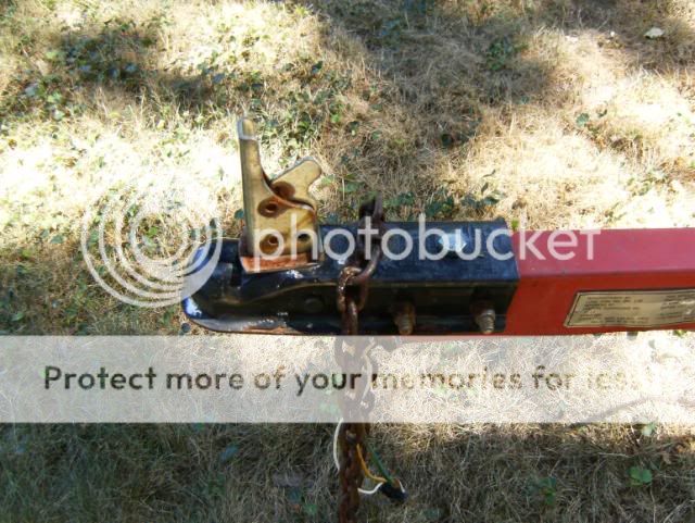

Here are some pictures of the winch set-up, rusty old coupler, etc. Notice the patches of rust throughout:
