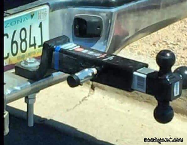

Ant then there is this contraption
Jan 27, 2018
21
What could possibly go wrong with a setup like that. Only thing missing is a bit of dog leash for safety chain.
Bondo
Apr 17, 2002
71,545
Ayuh,..... I wonder how many died in that accident,..??..??
poconojoe
Sep 10, 2010
1,966
What the...who the...LOL! I guess he did it that way so he can easily switch ball size. Hope he isn't hauling anything over that bumper's limit. And what is preventing that thing from pivoting at the bumper? Imagine it pivoting around and locking up on the side of the bumper! That trailer will be all contorted. BAD idea altogether. Some people...IDK. He probably thought he had a great idea! He should stop thinking!
M2HB
Oct 7, 2017
206
As I have said many times, “tools to some people are deadly weapons”.
dwco5051
Sep 14, 2008
2,587
I like that 6" long bolt that is probably half the size of the hole it goes through so lets put a big washer on top.
MRS
Jul 10, 2005
2,581
Hey as long as they go straight and do not turn or stop should be ok. :faint2: Kind of like that movie where the bus could not slow down or it would blow up. :nightmare:
M2HB
Oct 7, 2017
206
That is a lot of leverage on a stock bumper.
It makes me sick just looking at it.
Scott06
Apr 20, 2014
7,687
Common guys he double nutted it for safety. You'd think he'd win the Darwin Award...
jimmbo
May 24, 2004
14,702
Just another example of Hill William engineering at its finest, by Stuart Pid, just call him Stu.
bigdee
Jul 27, 2006
2,667
Most step bumpers are rated at 3500# IF ball is mounted directly on bumper. Why in the heck he put a receiver on it is my question. I don't see anything gained unless he needs multiple ball sizes and 2 balls and a wrench would be a safer alternative.
Lightwin 3
May 18, 2010
300
You thought you made something idiot proof and then, low and behold, along comes an advanced idiot.
