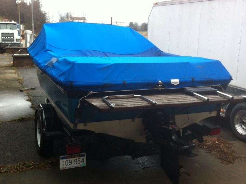

I see why the deck is soft in the back, that boat cover makes a nice little pool when it rains.
You'll need to figure in stringer repair to go along with the deck repair, maybe a transom too.
I personally don't think the boat is worth more than $2000, if that much. there's an easy $1000 worth of repairs that need to be done to it.

I agree. Plus, his gambit of adding to the price come Spring? Good luck with that. An additional winter is NOT going to improve the boat- rot never sleeps- so the boat is going to continue decreasing in value.

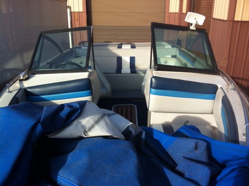

Yes, it sounds like your biggest issue may be structural rot, based on the soft floor, as the others have stated.
Repairing a boat's structure is really fun . . . :puke: . . . so you should probably check that out, as the purchase price may be just a down payment on the cost to get the boat in a safe, usable condition.
I would want to see the engine run. The boat will probably be there in the Spring time . . . and if not there are plenty just like it.
