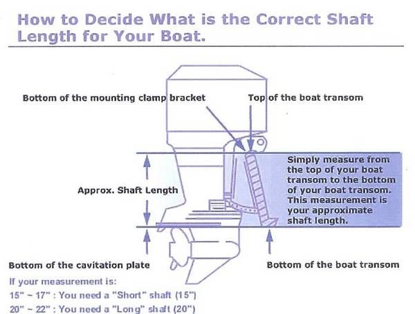

Anyone know what shaft length this is? (picture attached)
datoshway
Apr 11, 2012
7
I can't tell what shaft length this is. A little help?

Re: Anyone know what shaft length this is? (picture attached)
short
BonairII
Jun 7, 2011
2,727
Looks like a long shaft to me.
Texasmark
Dec 20, 2005
14,897
You are probably running a 10" prop on that engine. So, scaling off that in your pic looks like 20"....pretty long for a 15.
Mark
Whoopbass
Jun 29, 2006
653
If you have access to the motor then measure from the under the lower motor cover where the motor block bolts to the bottom to the bottom of the skeg. If its roughly 30"-31" its a short shaft 35"-36" its a long.
Chinewalker
Aug 19, 2001
8,902
It is a short shaft (15-inch transom). The long shaft Johnrude 25/35 was significantly longer under the "horseshoe" at the base of the swivel bracket.
bonz_d
Apr 22, 2008
5,276
I have basically the same engine, Evinrude, and yes that is a short shaft for a 15" transom.
seahorse5
Jan 24, 2002
4,698
The model number will tell you.
