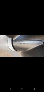

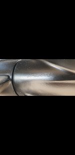

These are the numbers on the props but I'm not sure what they correlate to
Cheers

Never have understood the numbering on VP props
My thought is maybe its over propped if the compression is ok (150 psi). If compression is low, then its just a tired motor

Depending on hull, props may be B3s-B6s. I ran B5s and B6s on my 3500# dry / 4300# wet boat

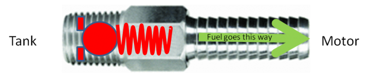

Antisiphon valve on the fuel tank can cause this; had the same problem on my boat a long time ago....
