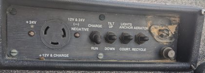

Just getting into the boats.
Bought an Astroglass 17 bass / ski
Trying to figure out the connections on the bow.
Please see attached.

on-board charger connection for the trolling motor batteries.
DBB512
Sep 10, 2023
2
Is it a
Ok, so this looks like a 30amp plug? And if I understand the lay out depending on if I'm using a 12v or 24v power for the trolling motor is how I would wire the plug?
110v 30amp
24v + upper left and - (nut) upper right
12v + lower right & - (nut) upper right
Where would the ground go? Or would it just be the power, & neutral no ground
53,077
that is an AC plug. you should have an on-board charger
you will have to look next to the batteries if the charger is still there and test it if it is still functional.
