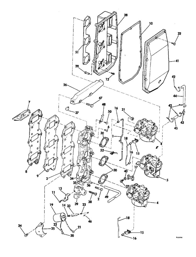

This question will probably be more suited to the engine section of this forum, but I will post it here for now so you guys know where I am at.
Would it be possible to swap out the air silencer cowling for some kind of filter system to keep the intake noise down, or would this likely cause more problems down the line, I cant think of any immediate problems doing this but just in case I am missing something.
The reason I ask is I could really be doing with the space the cowling takes up to fit my alternator in the space it will leave after removing it.
Outboard details : -
Johnson 1979 75hp 3cyl - Model 75ELR79R

I can't answer your question, but this pix showing the silencer (part #28 & 41) may help someone else:
Maybe a high flow filter system that mounts directly to the top of each carb, like a 30-40's open hood roadster:

Thanks for posting the diagram and pic for me, that helps explain it a lot better. I was thinking of individual K&n style filters or similar for each carb, exactly as you have suggested. I can get a hold of ones small enough for a reasonable price, I just have to make up base plates for them so they can be mounted directly to the carbs. I'll not be attempting it for another few weeks, so gives me time for more research.
If I could do away with the air silencer housing it would be the perfect place to mount the alt. as I could use the starter mounting bolts to mount the alt. bracket too, and there is also a suitable mounting location for the adjuster mechanism close by, and as an added bonus I would only have to add a small amount of space to the hood to accommodate the alt. So I'll make a start on mocking up some brackets to see if this will work but I'm 95% sure it will be perfect.

I also took off the air silencer I was talking about , and as you can see it frees up loads of space. The only problem is on the bottom of the housing there is a hose that connects to the crankcase, im pretty sure this is a vaccum hose that sucks in any fuel that may escape from the carbs. Correct me if I'm wrong. This hose is obviously for saftey and efficiency so I will have to incorporate a way of keeping this function without the silencer assembly.

morebass 17, I have a carb set up just like this, I know what you are dealing with here. I have never considered taking my air box off but if I was to do what you are trying here's my idea:You could take some measurments and find the right size PVC caps, cut out the center and trim till you like it, then add some of those lawn mower filter that looks kinda like a bowl that you zip-tie on. Just a idea here but you might like it. The air box is a hard thing for me to concieve removing. I do understand your thoughts but the air box usually does not have a filter. I know if you remove it, you will have to have something there.

Hi chasin-tails, thanks for the info mate, Thats pretty much what I was thinking, I was gonna take a template of each carb opening including the mounting bolt holes and make up an adaptor that will bolt to the carbs and also accept a filter. I know that these outboards dont normally have an air filter, much the same as most outboards,to my understanding the reason for this is that out on the water dust levels are extremely low if any at all. The only reason I am thinking of filters is to reduce the intake noise from the carbs, and also restrict the air flow ever so slightly. This is basically all that the silencer housing does, it diverts the airflow which inturn makes the induction a little less noisy. (well thats my understanding anyway) its just a bonus that the filters would eliminate any particles that might find thier way inside the motor hood.
My only concern as stated is the fuel leak off hose attached to the bottom of the silencer, I will have to accomodate this function which will not be too difficult. All of the mod's I am planning are completely reversible, so if something does not work the way it should I will start from the drawing board once again. Thats the thing with boat restoration, most of it is custom so its trial and error.
