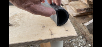

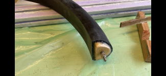

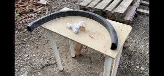

On my way. I have cut of a sample and will try to pump the profile up in the hope, that it will staighten up after many years on storage as a coil. Then I can better sand it and perform several glue tests at once. Now waiting for the epoxy to dry.

Nothing to lose.
But if its been coiled up that long, chances are good it has a "memory" which you're not going to totally remove without some extreme measures.
